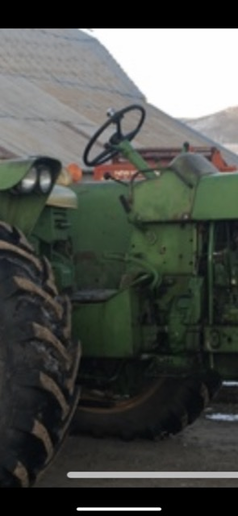

Different oil can cause leaks switch it back . I switched my
3020 to cheap hydraulic oil not long after I developed a leak at
the bell housing switched it back to hygard and it stopped .
Before cheap oil first photo after cheap oil second photo after
switching back third photo
