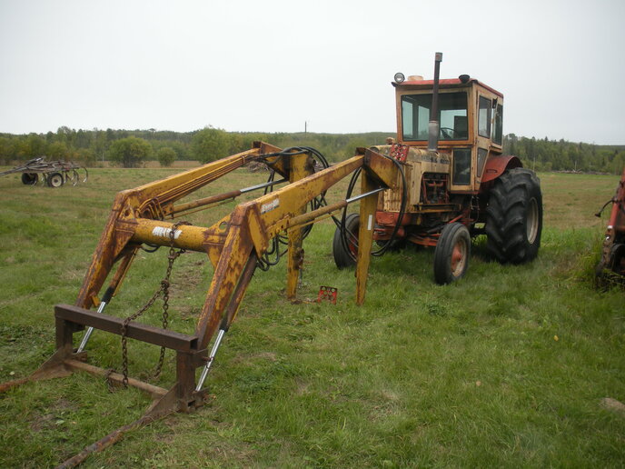

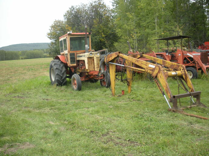

My CASE 930.model (940..Gasoline Engine)
FLIP STOPS UP Lower rail on Radiator end. Place bucket on ground...back tractor up.
As loader RAIL telescopes from STATIONERY RAIL on TRACTOR, allow loader rails to move down to ground...back out of loader.. disconnect hyd. lines.
Bob
