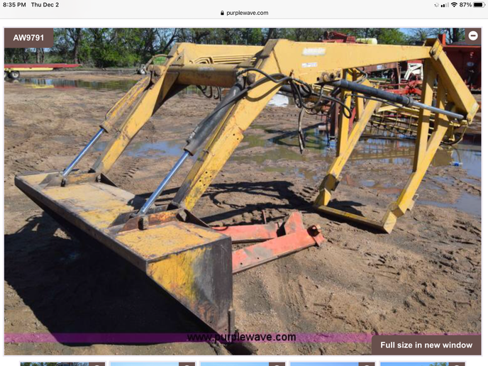

Usually the front support is made so the loader can slide on it as you back out some. Then lift on the loader arms pivoting the frame down.
Pic stolen from web.
