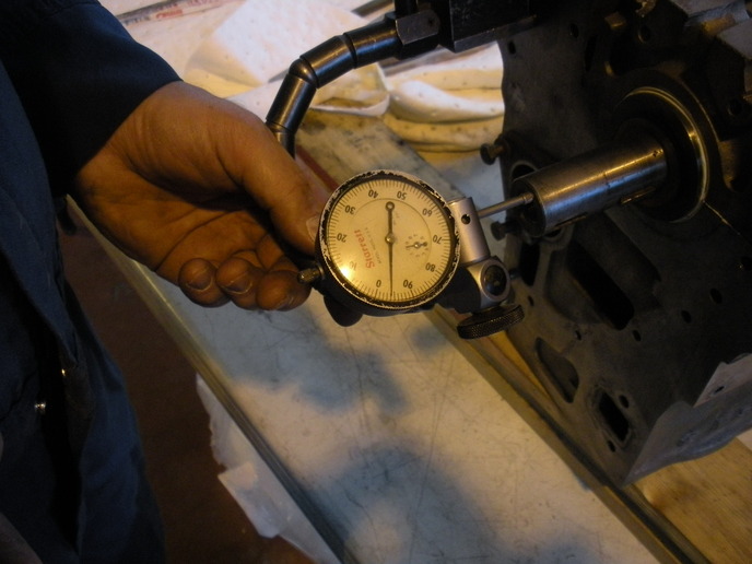

Note picture...Dial indicator indicates THRUST clearance on Crankshaft...
Verify in service manual the Specifications for the crankshaft thrust.

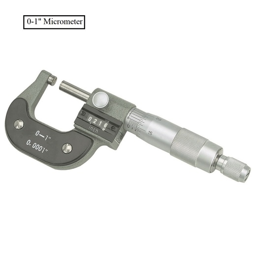

With a 0>1 Micrometre check thickness of PRESENT Thrust washers that are installed on crankshaft.
Order Thrust washers proper thickness to reduce Crankshaft Thrust to within specifications.
With all due respect, the engine in your Tractor was engineered to specific operating Diesel Engine tolerances and shall never last if not assembled as to the engineered specifications.
