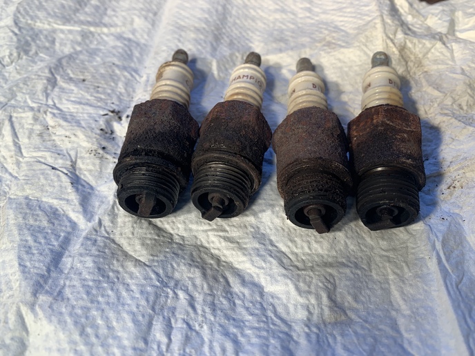

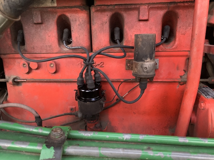

The ignition parts I ordered from John Saeli arrived Friday afternoon so I went to work getting the Case running again. I took the advice you guys gave me and replaced one component at a time starting with the points. After installing them the tractor started right up confirming they were the main issue. It still had a miss which i found was at cylinder 2. I put the new plugs in and still had the miss so I went ahead and made up the new wires and put on the new cap and rotor. That solved the issue, starts up and runs smooth now.
Here are some pictures of the parts I replaced.
