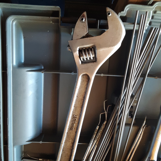

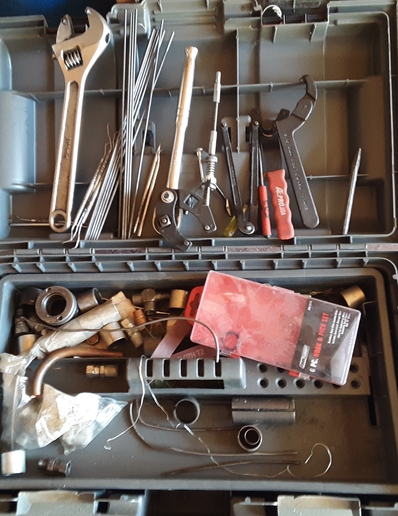

My favorite spanner I made using cheap HF adjustable wrench and 2 press pins.
I have a hydraulic shop close by. The owner is very helpful for parts and advice. Hard to believe she knows the best part to use. If she doesn't have o ring in stock, she orders it and I'll have it in a day or two. She even shows me how to install a U seal I couldn't.
Old dental tools are handy.
An electric tea pot filled with motor oil heats and softens o rings making it easy to install.
Small engine honing stones help clean rusty ends.

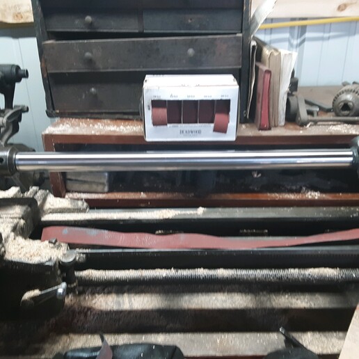

Lathe and assortment of Emery cloth to polish rid.
