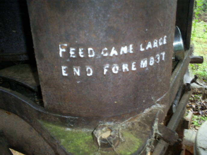

TAS, here is what I was talking about when feeding a syrup mill.
I rubbed soapstone on the print to make it show up.
Years ago, I repaired an old mill that the bearing holders were broken in because someone put the small ends in first and over fed the mill and when the big ends got to the rollers, it broke the bearing holders.
