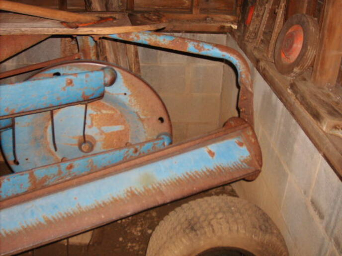

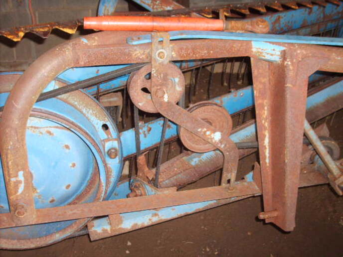

I have a 503 rake, PTO 3-piont, if that's what you're looking at. It has trouble with real heavy windrows as the frame doesn't have a lot of clearance so the hay bunches up under it. Also the shaft is low so if the laying hay is thick it will wrap around it. Raking into the breeze can cause the hay to lift up and wrap around the stripper. You can always take a half width then rake them together later, or just go real slow. Some have a way to switch the shaft to get a lower reel speed, mine doesn't. Pics show right and left ends of the stripper. The right end is pretty low so if the hay is thick it will wrap there and push the belt off. PITA to get it cleared and back on.
