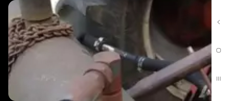

Is the suction side hose kinked?
Is the suction hose big enough? Should be double the size of the pressure side hose and the size of the port on the pump.
