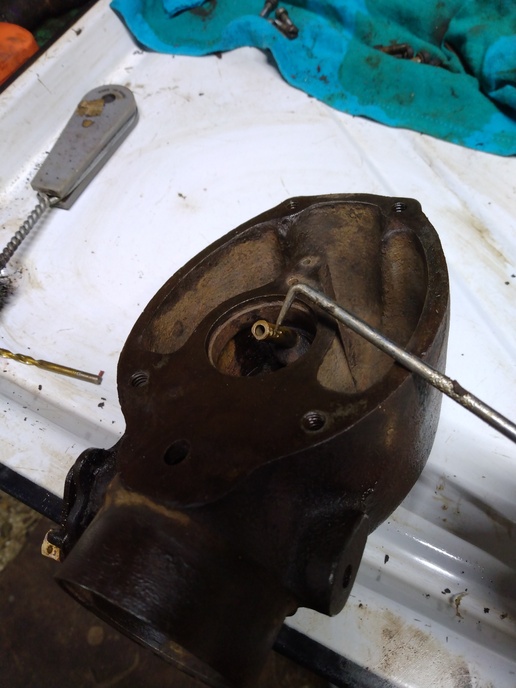

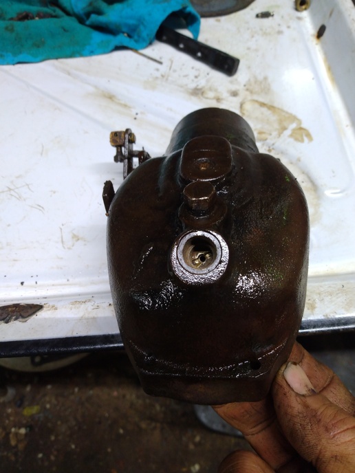

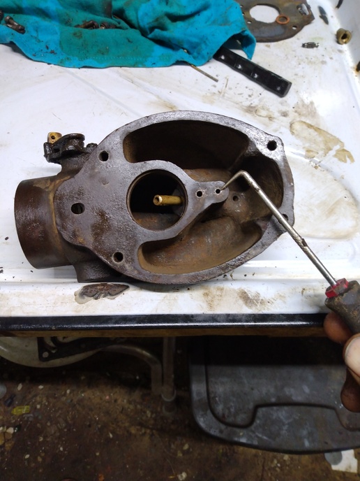

Got it all back together and fired it up. Wasn't running exactly right. Took a break and went grocery shopping. Got back and tinkered around a bit. Decided to pull the carb off and have a look. Sure enough one tiny hole was plugged up. Tried everything to get it cleaned out, no go. Realized we had a parts carb with the same bottom half. Swapped it, stuck it on tractor and we running like a Deere! Was out driving it around the yard in the cold, dark, rain! Lol.
