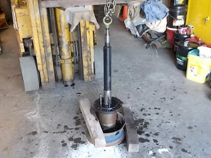

To begin: The parts book diagram is your friend. The work is straight forward.
Cleanliness is necessary.

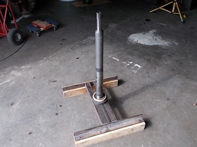

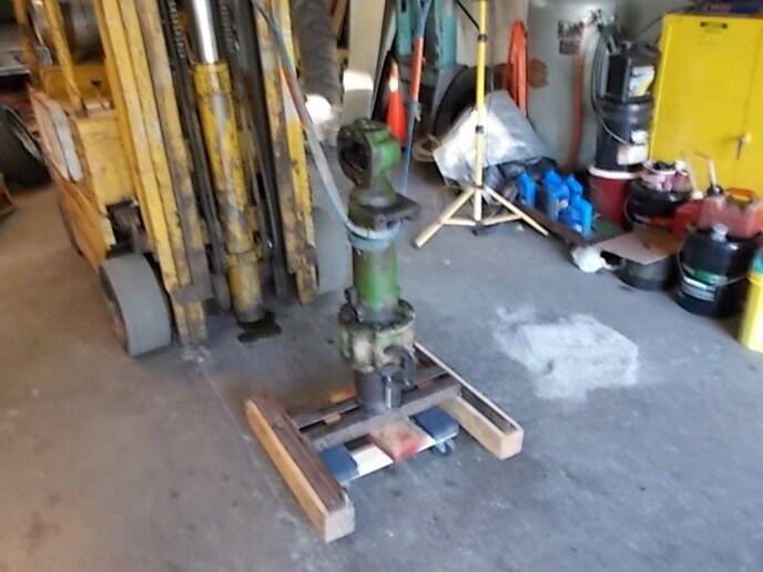

The nose has to come off--then before much else happens make a protector for the radiator out of thin plywood or some corrugated board so it fits in front of radiator and stays there. When the wrench slips off bolt or fitting you will know why. Tractor is jacked and supported, front wheel assembly removed. Loosen the gear at top. This can be a hassle but best to do while unit is still solid attached to tractor. Loosen the 10 bolts while on tractor, 5 of which will come out to get unit off. Next is have a lift set up to move the unit. I made the stand to support the thing while I worked on it. Parts were on shelf at local dealer. Check the date code and make sure especially the rectangle seals are not older than a few years. Some guys had trouble getting the new ones on. My seals were less than year old and went on easy. Harder to get the old ones off. I will post some pix of the work. Can't recall if the 720 manual covers this activity or I had the PS manual or the IT. Email should work if more ??
