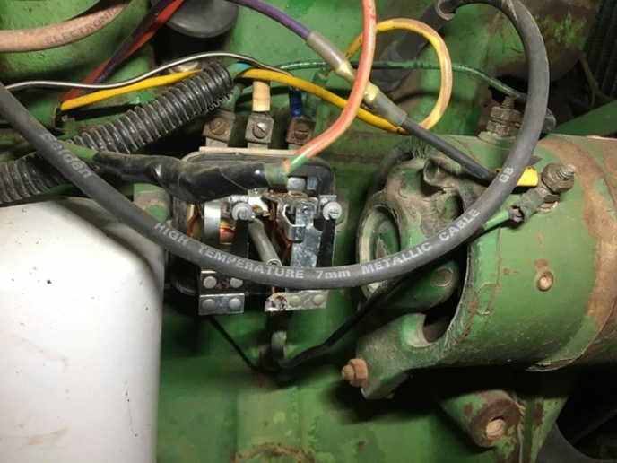

Im back on the 550 again. It quit charging, trying to figure out why. Its positive ground,12 volt system. I used a test light while running, the only power I get is the middle,top terminal on the regulator . No light on either terminal on the generator or any of the other terminals on the regulator. Is the generator the problem?
