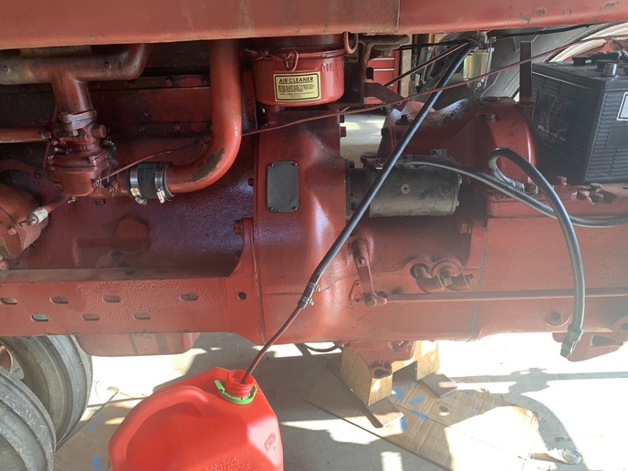

The auction M part 8. Update to surging lugging down
Posted by 1939farmall on October 04, 2021 at 14:32:24 from (172.58.62.138):
Last week I posted that we were running the M around and I noticed it was really lugging down under any kind of a load. I was thinking it might be a problem with the governor. Most of the comments I got said it was most likely a fuel problem. I was wrong and you guys were correct! I had time to look at it today and sure enough I got very little gas flow at the tank. So now Im draining it and Im going to pull the sediment bowl out and see if I can add a short stand pipe in it so Im not sucking off the bottom. The tank looks really clean but it seems like its plugging up with very fine rust. Maybe from under the baffling where I cant see? Thank you all very much! I really appreciate your help! To be continued. . . .
