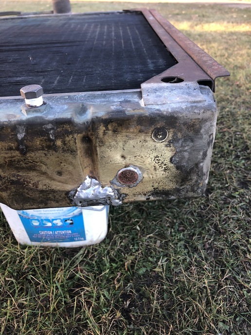

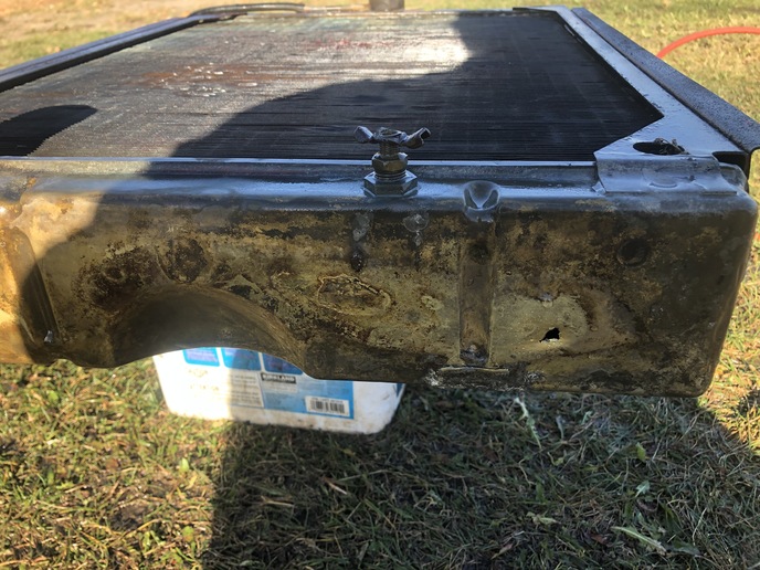

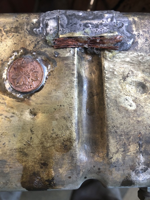

just got out on the field and she started dripping. kinda expected it though as the bottom was moist. pulled it apart yesterday and wow only thing keeping it from pouring out was the mud. i got it soldered up and not leaking yet. good thing i saved some pennies, came in handy for that big hole. soldering that previous patch was more tricky. should have just removed it and started over. took some copper wire and set it in the crack and soldered it that way. put a piece of rubber tube on the bottom now so it have more protection.
