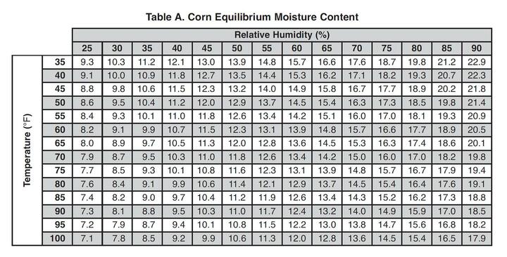

Here is a chart showing the potential drying capabilities of air at various temperatures and humidity levels. I think your corn should dry down OK.
