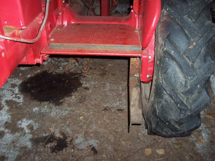

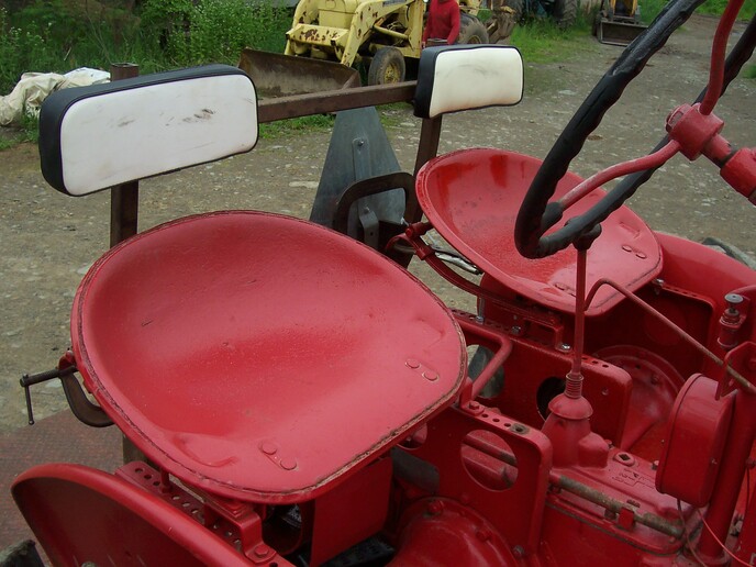

I put the whole seat assy from an A or B (don't recall which) on my BN. Direct bolt-on. I made the floor from a piece of salvage sheet steel (think it was NOS manure spreader side), with 2 pieces of angle iron underneath for strength. I think the only diff between B and BN was the extra width on the axle castings and guts, making the seat sit away from the fenders, so you would need the pieces Gene talks about.
these pics were from the engineering phase, before I made the step for Linda, and bolted the backrests in place.
the step, crude but it works.
