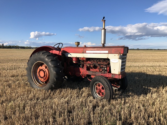

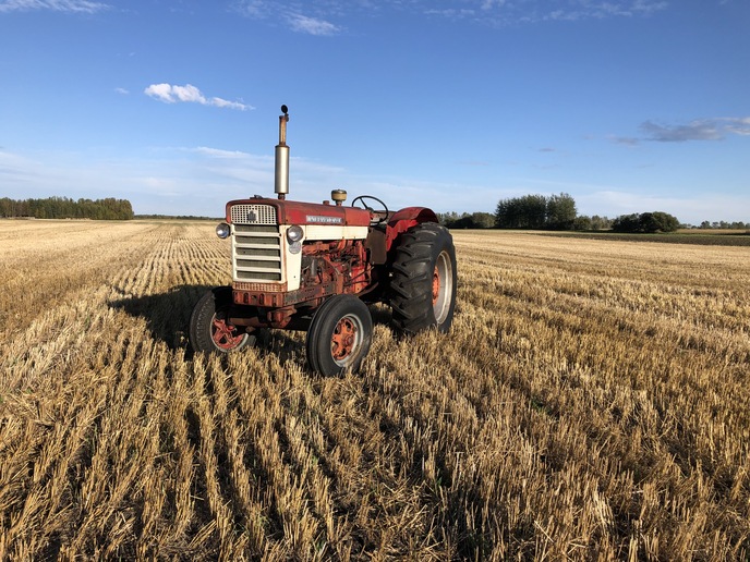

todays project. checked this 660 out. fuel at sediment bowl to pump was shut off, very bad deal! i never advise of that on a diesel engine. been caught already a few times by this. this causes the pumps to rust and get water in them. this one is screwed. running out of 660 pumps... had to rob one off my working tractor. least i did not have to tear into the engine. left it soaking with snake oil. tractor sat for around 20 years. swapped pumps out and she is a runner. so here is the no cab 660 now. went for a tour around the field. another one saved from the scrapper.
