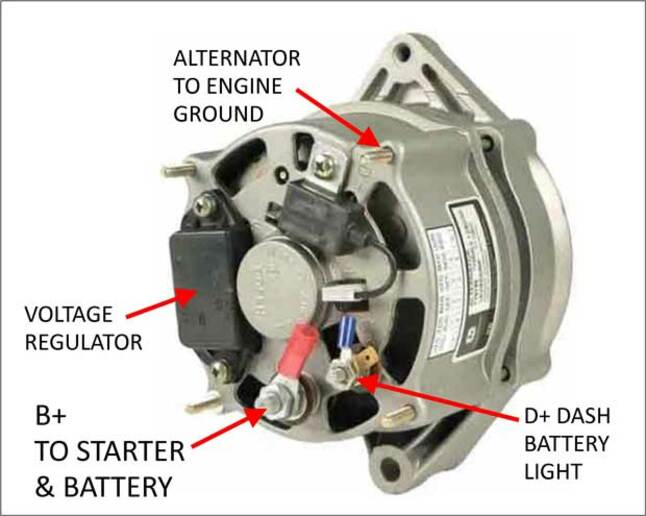

D+ goes to dash light bulb then to ignition switch I terminal. The bulb is needed to prevent run on. If the Wire you are holding has 12v on it with the ignition switch on, it should have a different connector, or a spade can be mounted on the D+ terminal. as shown in the image.
The B+ goes to the large wire from the old alternator. Ground can be made to the mount for the static suppressor (2.2 mfd) black box mount stud, to assure good alt ground.
