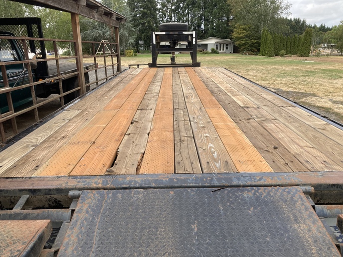

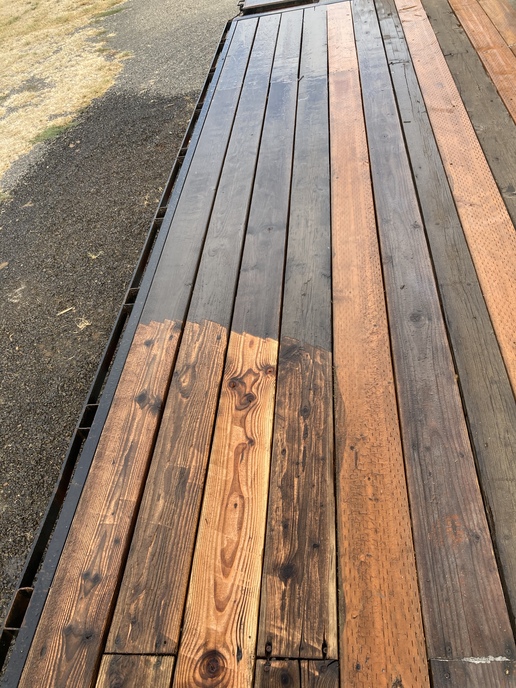

Ive been replacing the deck on my gooseneck 2 to 3 boards at a time as needed. The last that I changed I used pressure treated. The old boards were all kind of rotted at the ends so as I replace boards now Ive been sealing the ends of the board with roofing cement or whatever I can find to keep water from wicking in the end grain. As others have suggested, I tried used engine oil in the past. Got tired of the dirt and grime so the picture below shows the difference as I pressure washed those boards.
The photo below is after cleaning the deck and sealing it with a clear deck sealer that I got from Sherwin-Williams.
