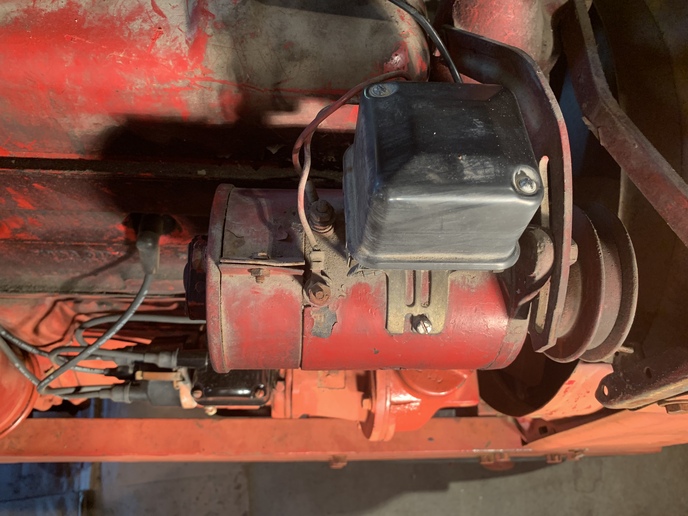

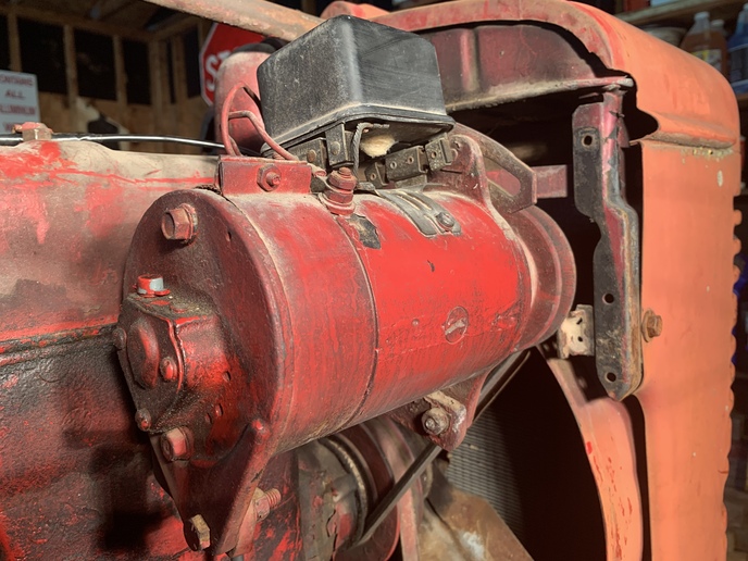

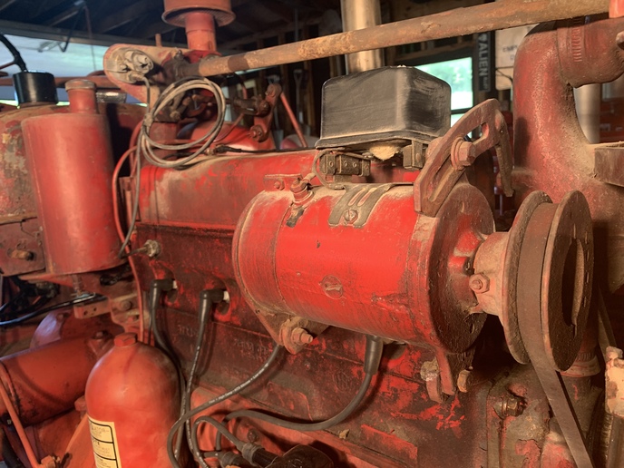

Im using a 12 volt battery to start the tractor. Im using the ground cable from the tractor to battery then using a jumper from the other battery post to the starter post. I do not have the battery wired into the generator wiring. I didnt want to put a battery in the tractor until I knew what type of generator I had, and I know I need new battery cables. I dont see any numbers on the generator. Im setting up my meter at the battery end of the generator wire. One lead to ground the other to the wire. My reading fluctuates between 13 and 14 volts. Here are pics of the generator. Thank you.
