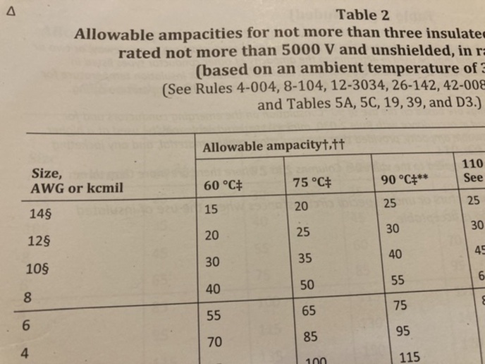

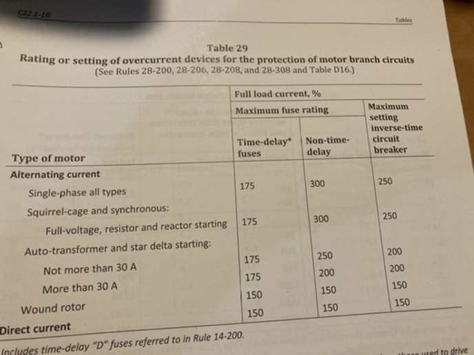

Section 28 CEC motors can have up to 300% fla on a non-
char breaker provided theres overloads to allow for motor
startup, number 10 wire is rated for 30A at 75 degrees and 40
at 90 degree wire I dont see where I messed up so bad?
