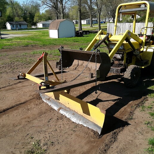

Only problem with rigid mounted front blades is they don't float over uneven ground.
A tree trimmer put a landscape rake on his bobcat. Didn't like it. Tore up the grass.

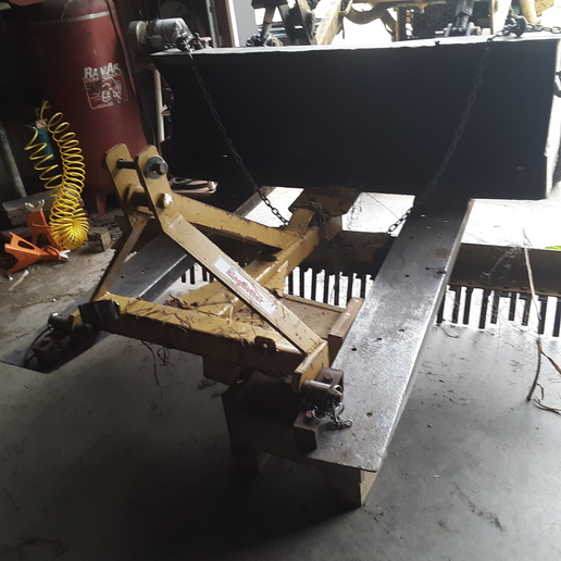

My homemade forks aren't ridge.
I've used blade on Jubilee and Kubota 3 pt.
Nothing compares to this redneck design. I can see what you are doing and apply down pressure.
A ridge mounted blade will cause a problem if one wheel drops on a pothole.
