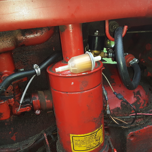

I installed inline filter. No pump. It
didn't let enough fuel to keep engine
running after gas level in tank ran low
The higher the tank gravity provides
enough pressure for fuel to flow.

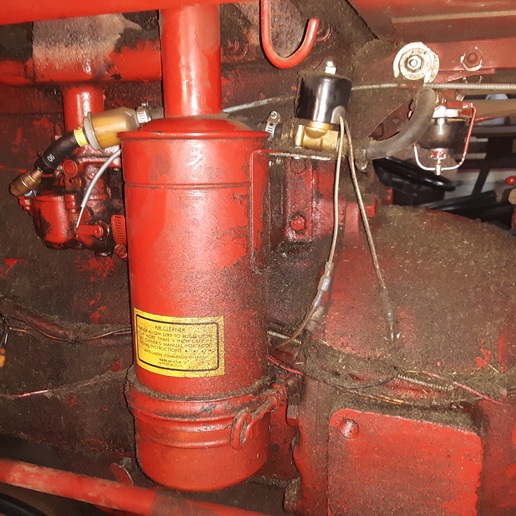

I removed paper filter and install a red
screen filter. Now tractor runs as it
should.
