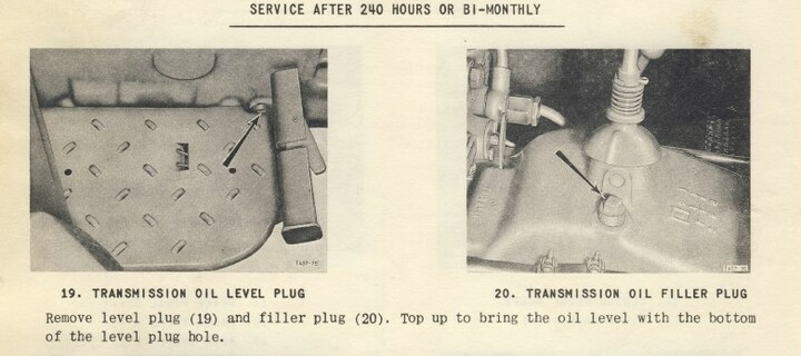

Hi, see attach photo from B414 Operator's Manual.
