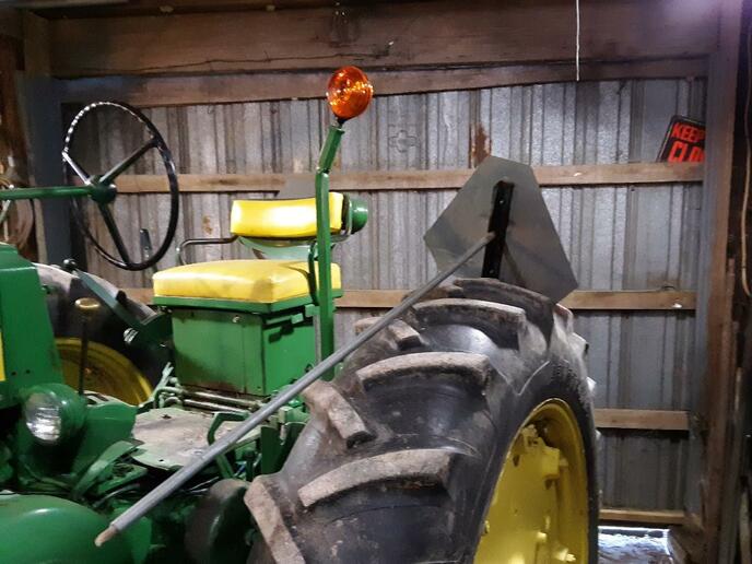

You didn't mention what tractor. . .
Here's what I put on my Deeres. No fenders, so I had to improvise a post to mount it on. The flasher is in the battery box under the seat.
I re-wired my Deere headlight switch. It had a dim headlights position, and I removed the resistor and wired it so the hazard light will flash with the headlights on for night travel, or it will flash by itself for day travel. It's really simple wiring - if you sit down and think it out you'll have it solved in no time.
I used a motorcycle flasher on one tractor. On two others I found a flasher on ebay that will flash an LED properly, plus it will also work on positive ground tractors.
