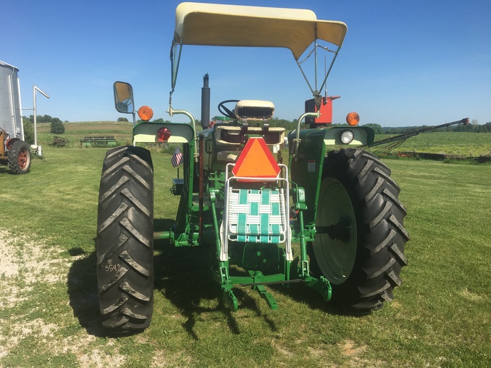

I added 2 to the back of my 1550. I used a toggle switch, flasher unit and 2 lights and a roll of wire. I had an unused fuse holder that I hooked to, wired so that when the key is off, power is cut to the fuse.
