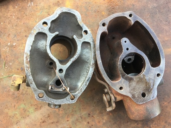

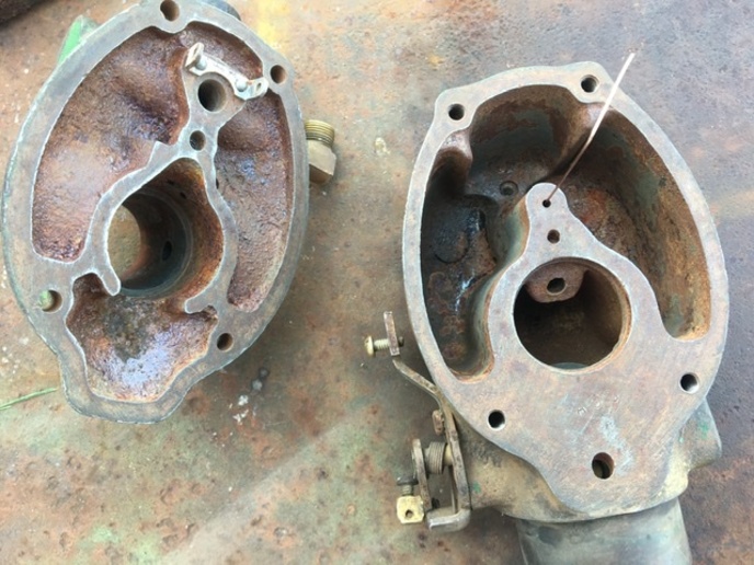

I started it and sprayed starting fluid around the intake manifold and no change in rpm, so no leaks there. I took the carb off and apart to cook it. It is a TSX 903.
The wire is in the hole that the wire wont go through. I figured since I was cooking, I might as well do the carburetor for the 88 also, so I took it apart too. Its aTSX374. Where the wire is sticking out, I dont think theres a jet in the hole,on the 903 there was a jet in this hole. Am I missing a jet??
