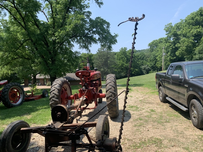

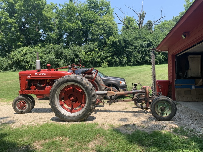

I got this at auction a couple of years ago and finally decided to give
it some use. It would run fine for about half a round then started
slipping. I stopped several time and cleared the bar, the last time
when I started the PTO nothing happened! PTO turning bar not
moving. There are metal shavings all around the slip clutch so Im
sure its stripped. Ive never opened one of these up before so before
I get into it I have a couple of questions. Is the clutch on a splined
shaft of a keyed shaft? I dont hold much hope for finding parts so if
the shaft is not repairable why couldnt I weld it solid and use a slip
clutch right at the PTO on the tractor? As always thanks for your
thoughts and advice.
