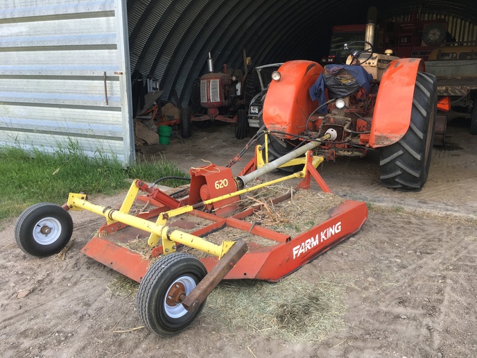

The wheels on my Farm King rotary mower have been in rough shape for years but the one tire finally started falling to pieces on the last day I used it last fall. Got a pair of new stub axles, wheels and tires from Princess Auto. I had to fabricate some framework to hang them on. Just some leftover scrap iron like most of my work but it seems to have worked out ok. I had it out for some cutting with the 730 Case recently and didn't break it. Rides nice and smooth on the new tires. Old ones were solid rubber with plastic pipe bearings.
