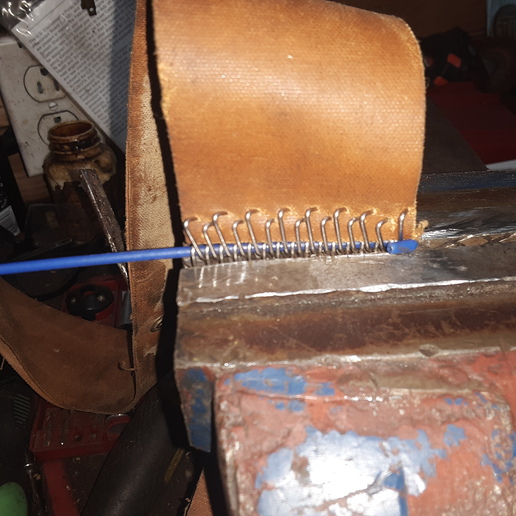

Keep in mind, this is the first time I've repaired a flat belt.
First I cut the old end off with a cut off blade.

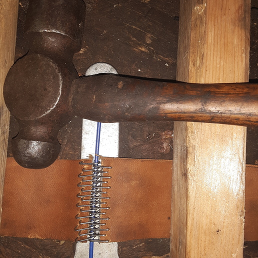

Then I screwed 2 2x2s to work bench to position belt and clippers

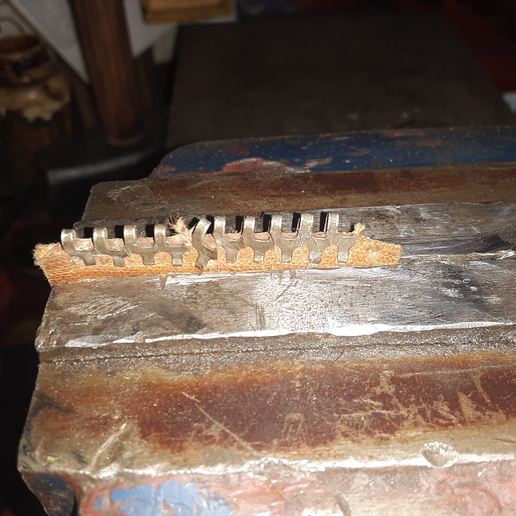

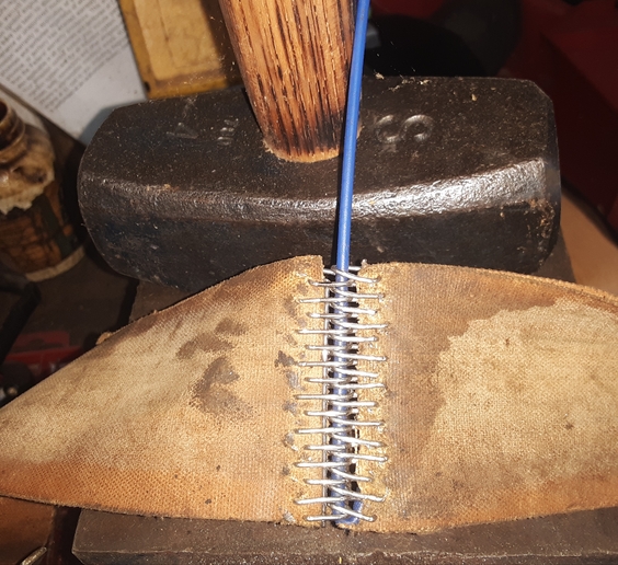

Used 16 oz wacker to hammer clippers together. One side went straight to, the other side didn't. So I straightened the clips with needle nose and squeezed with vice.
Finally I gave it some adjustments with 48 oz calibrating tool.
Mission Accomplished.
