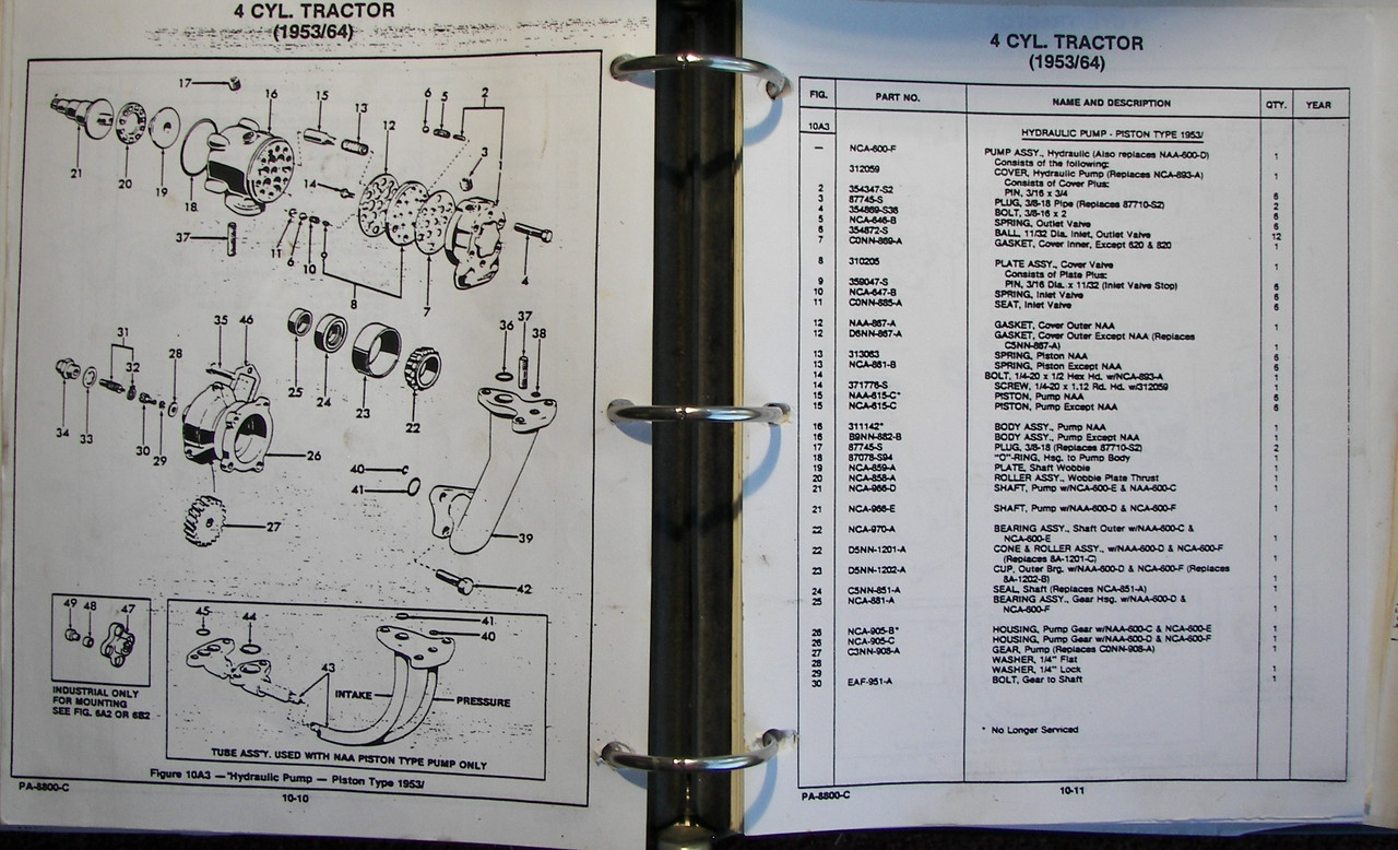

NCA-905-B is the pump gear housing for piston pumps NAA-600-C and NCA-600-E. See the parts diagram below.
