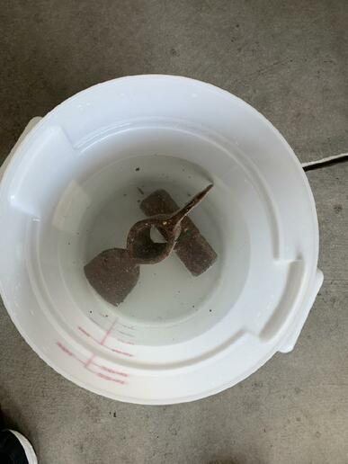

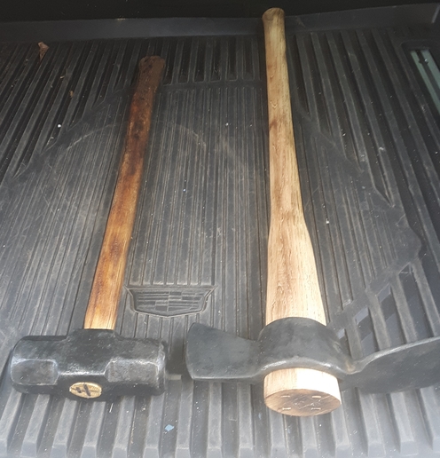

My boy soaks rusty axe and sledge hammers in a mold solution of food citric acid.
Then he uses flap sander to take care if the rest.
