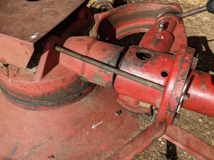

and children of all ages. what hobbyist hay farmer in the east does not have a well used up manual fold four spinner tedder that has slop in the outer wings. I have such an animal and thought I would try this complex design to help hold the outer spinner in place. Simply a piece of 7/16 all thread with a nylon lock nut on one end and a hitch clip on the other end. It does add another small step in the process of manually folding and unfolding the wings. I have not used it yet. any and all criticisms are welcome.
