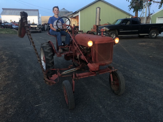

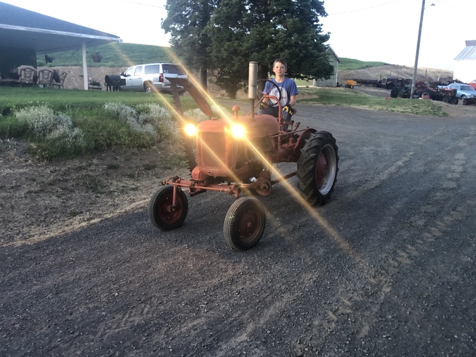

Farmall Cub runs
Posted by mschwartz on June 20, 2021 at 22:33:23 from (216.163.103.95):
Cleaned the fuel tank, sediment bowl and carb. Made new battery cable, filed the points and it still would not start, looked closer and someone had the firing order on the cap set wrong(1234). Moved wires around correct and it fired right up. Son was happy with it, Mike
