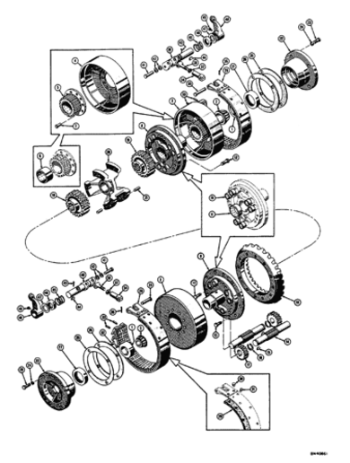

Somebody was trying to sell 310G steering clutches. I made an assumption My bad. I had an OC2 with that, and it was a power robbing failure to turn beast. If it is turning left when either lever is pulled, there is something wrong with the differential, and the right hand finals past the differential. I think I see the spider gear shafts in the image I posted. Jim
