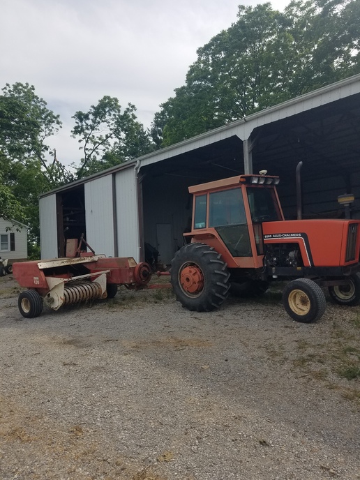

You are doing better than me. I have been
working on a no.12 Massey Ferguson baler.
It was completely out out of time. So slow
would hit the needles stop. Plus the
packer fingers were off almost as much.
Would have had almost no capacity. Have
the right side tying turning by hand but
the left side ties but I can pull it
apart. So almost there. Also the needle
eyes are worn a quarter inch. Will weld
and grind them smooth. Here is my first
good knot. We also have a IH 430W if I
can't get it. But wire is almost $100 a
roll.
