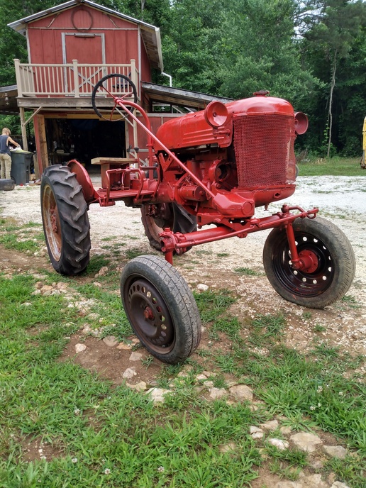

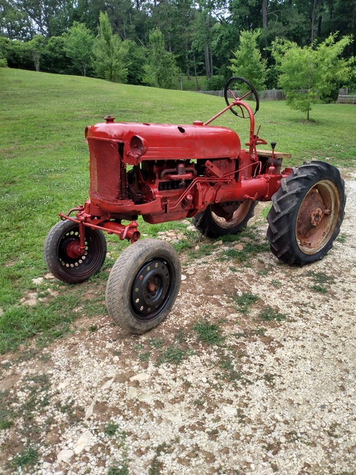

After digging deeper into the cub we
decided it's too far gone. Cleaned up
the valves and seats, lots of pitting. Adjusted valves and poured a little oil on each one,leaked past almost immediately.
Stuck a head gasket on and tightened it
down. Zero compression on two cylinders
and 5 psi on the other two. Block,head,
final drive, radiator and front bolster
all have a ton of brazing on them.
Governor and starter are rusted solid. Manifold
rusted through. Seat,carb, brakes and
hydraulic pump are missing. 3 out of 4
tires are shot. Both front rims have
rust rot. Gas tank looks like Swiss
cheese. Going to get a old sickle mower
mounted on it and call it yard art. This
is our 50th tractor and the first one we
took off life support. Will steal parts
off it as needed.
Got my spare car doughnut tires on
it to move it around!
$12 worth of cheap spray paint.......
It's yard art worthy.
