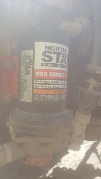

Just use a common one wire Delco alternator. Using a common 700 amp 12volt automotive battery from Walmart. It can handle the poop all day long, maintaining 30 to 40 lb of pressure, intermittent. I turn it off on turns and turn it back on when I start back up the row. Just use a common 12 volt push pole switch that is mounted on the fender for easy access . I use an alligator clip to hook to the starter lug for power. The pump is hey Northern Flowmaster type pump, rated 5 and a half gallons per minute at 60 pounds pressure. This is the third year on the pump. I have used this type of a system for over 15 years. The spray boom has 17 8002 nozzles, running 30 lb of pressure at 5 miles per hour.I can also apply 60 gallons of liquid fertolizer per acre.2nd gear about half throttle,25psi.
