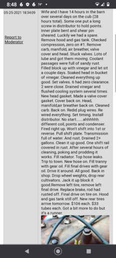

Screen shot of what I posted the other day. Everything we did to get that cub running.
