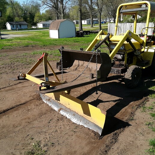

This is what I use to level dirt and repair driveways. I can
See everything without turning around. Fill holes before wheels fall in a hole. I can apply down force.
I angle blade, the forks will apply more down force on the right side and I can remove gravel from side of road and bring it back to the middle of road in the process filling in hole.

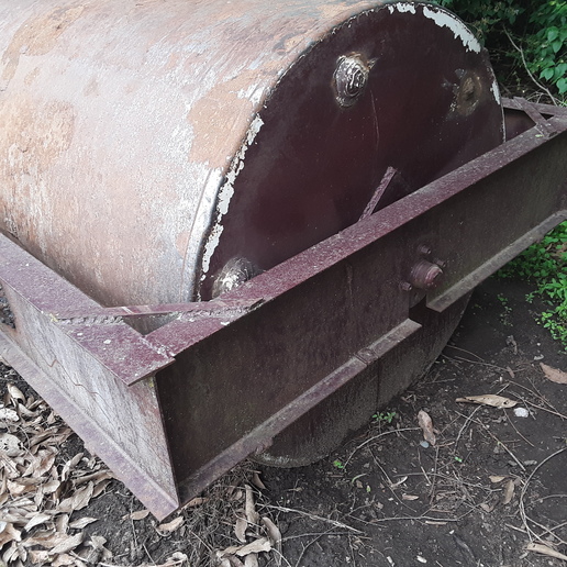

I have 5000# lawn roller. The best way to fix ruts in lawn is to use loader to add dirt and level dirt with back blade.

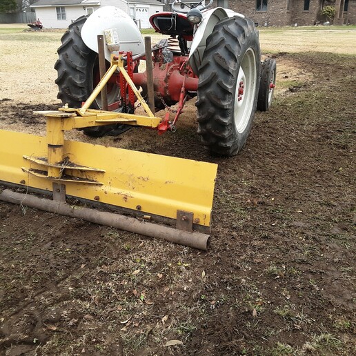

This pic I used Jubilee to level dirt on terramite to add dirt. Filled in ruts concrete trucks made.
I have no idea why my second pic wasn't the roller.
