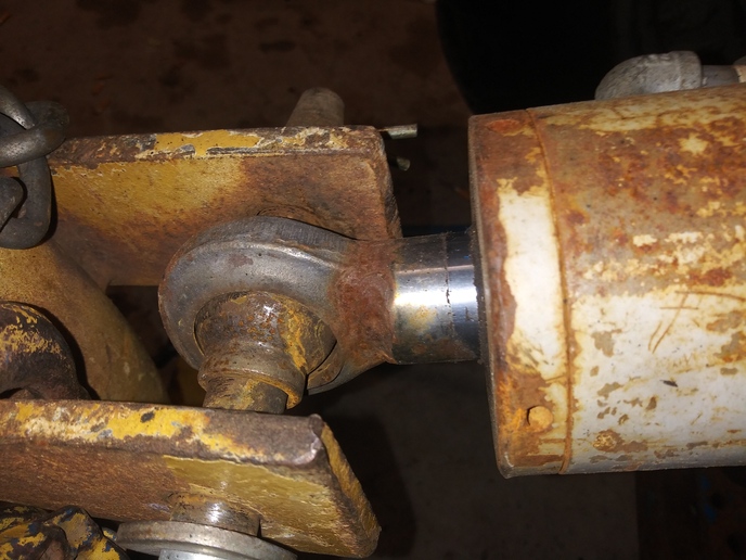

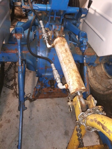

If you have a service valve then by all means get yourself a hydraulic top link.
I would cry if I had to go back to a screw type top link.
They are expensive to buy so I made my own. Bought a good used cylinder and cut the swivel ends off a screw type top link and welded them onto the cylinder.
With a hydraulic top link I can turn my back blade around without removing it from the tractor. Click the link for a little video.
