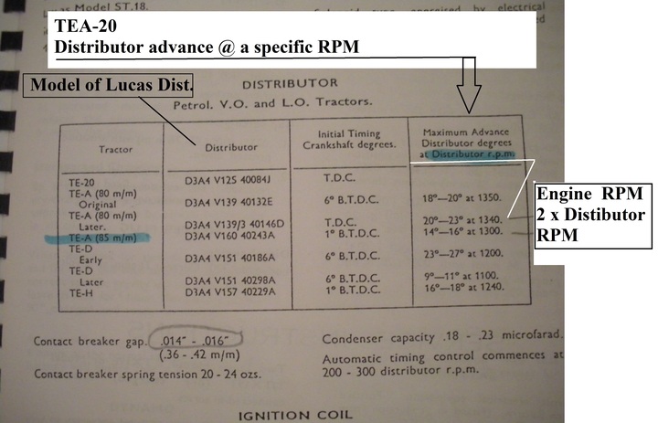

I used a strobe light to check the advance on my TEA-20....
145 teeth on Ring Gear.....360/145 teeth = 2.48 deg / tooth...
My TEA-20 has NO TIMIMG MARKS on the flywheel..........????
With the Starter removed, I marked a tooth at TDC..
Pull started the Tractor....
Bob...
