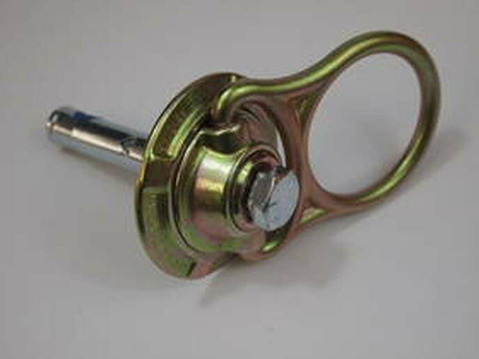

Purchase 7 of these. Then take tin cans and cut a hole in the bottom off to one side. Use a threaded rod about 6 inches long with a T welded to the bottom the can is used to make a depression in the concrete while pouring to allow the D ring to lay flat. Or a heavier one, or one made from a repair link in a big nut welded to the rebar. Jim
