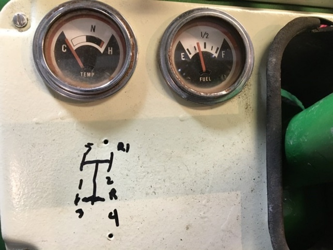

I finally got the guage to work!!! I added extra ground wire to
the sending unit and the guage and finally took the guage out
of the dash and scraped the paint off around the edges of the
hole and shined up the outside of the guage and put it back
in. Turned on the key and the needle moved. Problem now is
that it reads backwards. It has about 3/4 tank of gas and the
guage reads 1/4 full. Thats okay, I cut a stick to carry in the
toolbox. Thanks for all of the help!!!! Chris
