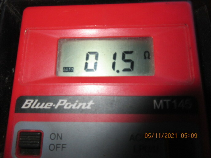

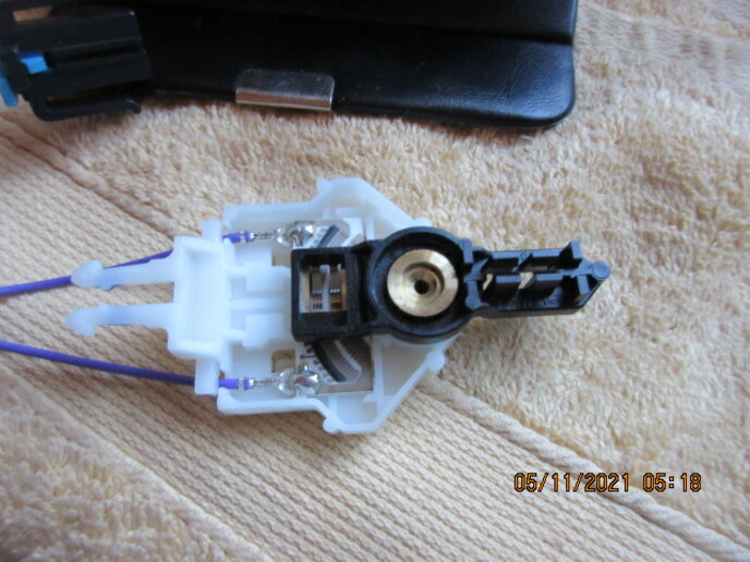

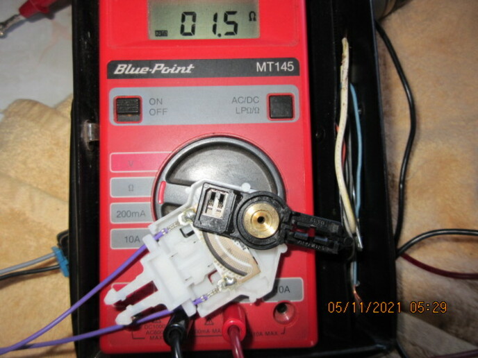

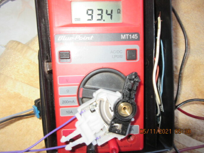

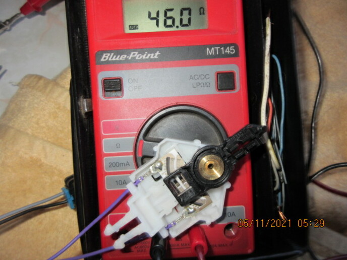

Here's the ohms on a brand new 97 Grandprix sending unit. 1.5 equals empty, 4.6 = 1/2 tank and 93.4 is full. We had a tool at work to check gauge operation which was two cables on a box with a knob and display, 1 equaled empty, 44 was a half tank and 88 was full, however that didn't necessarily hold true for all cars and sure as hell didn't apply to Olivers.
