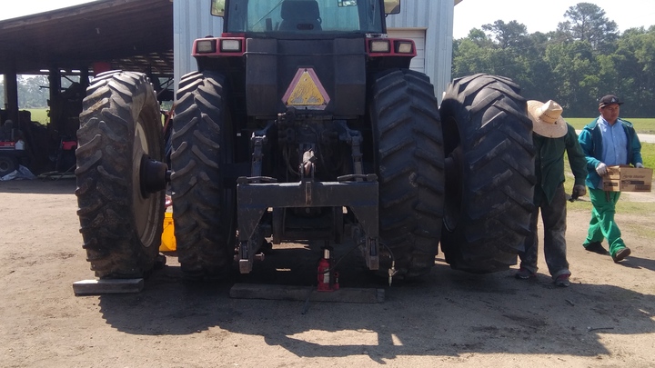

Just finished up today getting the last of the rear tires on the necessary tractors changed over. I had been running the 20.8-38 size that came on them new but last year I changed all the corn and soybeans to 30 inch rows. That didn't work well at all with too big of a tire on a bedded row. Finally was able to locate enough stuff to change to 14.9-46. Planter tractor sure works better like this. You just don't realize how much of a difference in room there is till one side of tractor is completed and other side isn't. Glad to be done with this task. Thanks to all who provided leads earlier in the year while looking for parts. Getting this 7120 ready to coulter in nitrogen on the corn.
