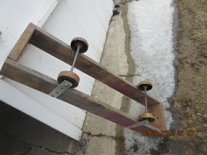

I made a hi tek fixture for working on rims, set the rim on the steel wheels and run a cup brush in an angle grinder and the wheel goes round and round. That's the way I paint them too.
