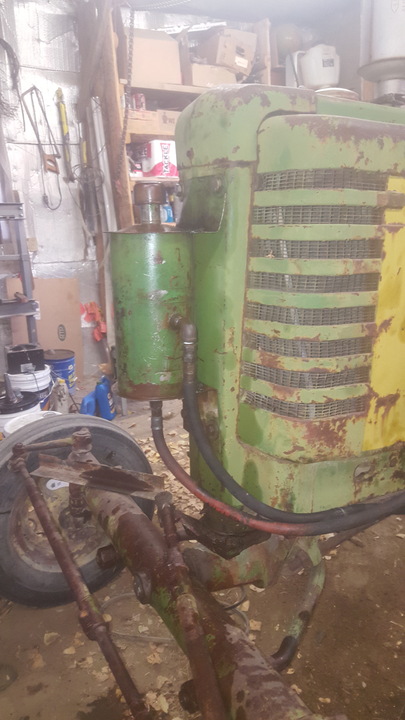

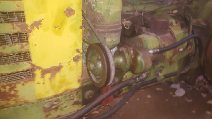

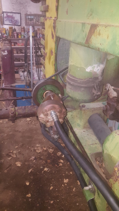

I added this pump from a John Deere Combine. It is belt driven from the fan shaft. the reservoir is upfront. Works quite well.
