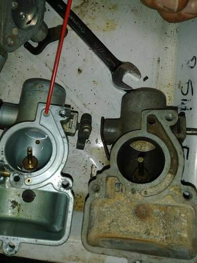

This is a picture of two cub carbs. The old one is original the new one is $35 Amazon. It needs to be drilled out. Should be a indentation where hole goes. I just used that as a gauge for bit size. Drills all the way through. Won't run right with out it.
After drilling we have 3 that work perfectly.
