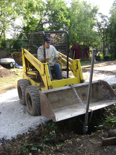

My CL40 Ford (74) will buck with the best of them. To the point I won't let anyone else run it. It has done this since i got it 20 years ago. That being said, I have learned how to operate it at all speeds smoothly. Some suggestions: 1) Make sure drive chains are tight. 2) Take as much play out of the control levers as possible. 3) Don't try spinning it like a top. Mine is worse on pavement or very hard surfaces. 4) IF YOU CAN'T GET USED TO IT IN SHORT ORDER, GET RID OF IT BEFORE YOU GET HURT!
